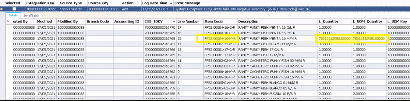

Problem Statement :
Record stuck in integration monitor. Showing below error.
System.Exception: DI:Quantity falls into negative inventory  [WTR1.ItemCode][line: 16] en ReplicationSBOIntegrationWinSer.IntegrationObjects.InventoryStockTransfer.CreateInventoryStockTransfer(DataRow[] objDataRow, DataSet objDataSetSerialBatch, Direction From, Direction To, String iVendSBOSTNumber, Boolean IsGoodReceiptST, DataRow[] objDataRowUserDefinedFields)
   en ReplicationSBOIntegrationWinSer.IntegrationObjects.Transactions.Replicate(Direction From, Direction To, Int32 DatasetRowID)
   en ReplicationSBOIntegrationWinSer.Integrator.MainStart(DateTime LastRetryAt, Boolean& Retried)
Cause :
If in any stock transfer customer scan the barcode in quantity by mistake .so it is generating millions of negatives for customer.
Symptoms :
NotApplicable
Resolution/Work Around :
Need to update Stock transfer detail with Quantity,QuantityOpen,QuantityShipped,UOMQuantity,UOMQuantityOpen,UOMQuantityShipped ,also need to update InStockQuantity, AvailableQuantity in warehouse ( Main warehouse , Retail warehouse , Intranset warehouse.
update InvStockTransferDetail set Quantity='1.00000',QuantityOpen='1.00000',QuantityShipped='1.00000', UOMQuantity='1.00000',UOMQuantityOpen='1.00000',UOMQuantityShipped='1.0000' where StockTransferKey='Enter stock transfer key'
and linenumber='enter the line number'
update InvInventoryItem set InStockQuantity=0,AvailableQuantity=0 where ProductKey='Product key' and WarehouseKey='warehouse key'
