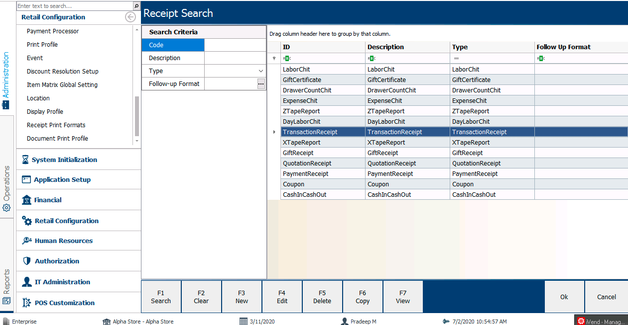

You can edit the XML format of any of the following POS receipts however this cannot be performed directly within the Print Profile window. The user must export the design via the Receipt Print Format window (Receipt Designer).:
Administration > Retail Configuration > Receipt Print Formats
Select Transaction Receipt and Edit
Figure 1 Receipt Search - Transaction Receipt

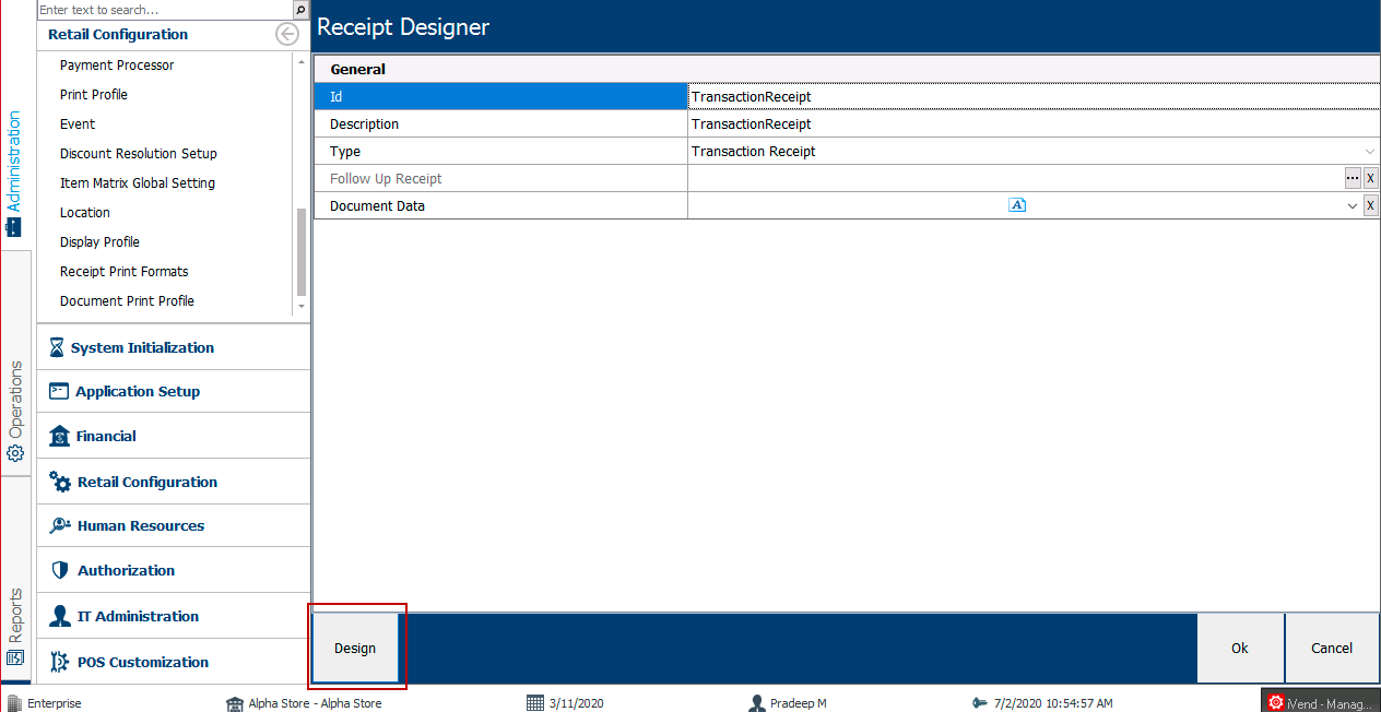

       On Receipt Designer click on Design button.
Figure 2 Receipt Designer

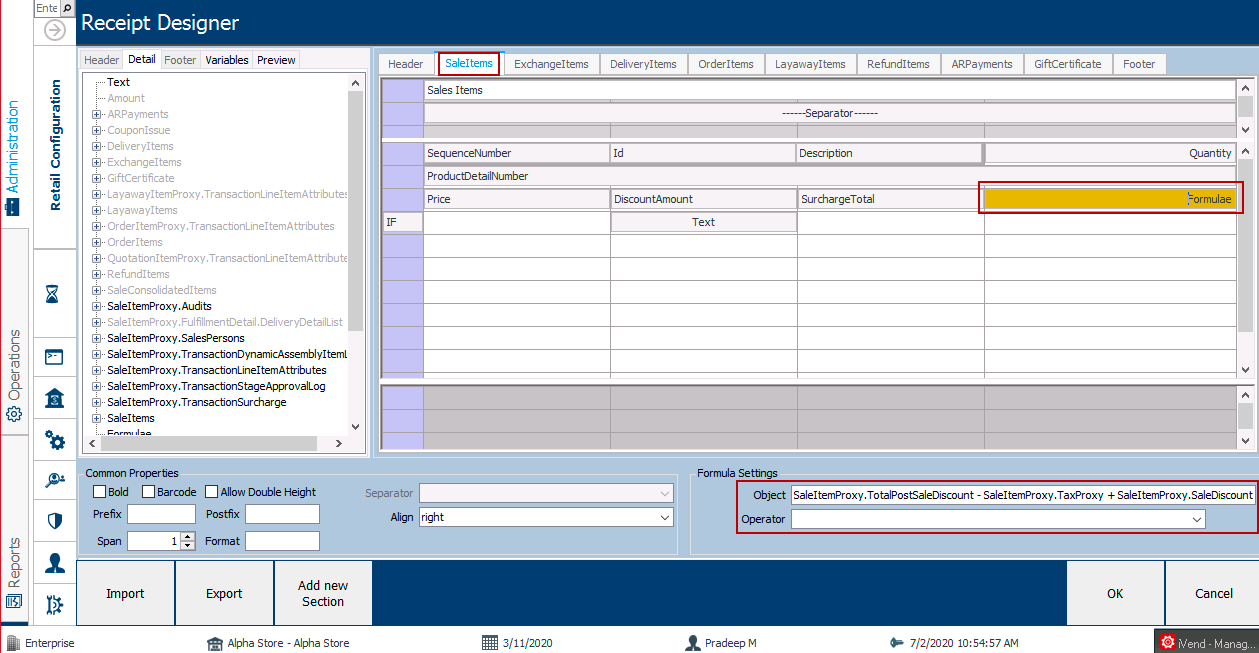

On Receipt Designer right pane select Sale Item Drag the if condition from the left pane to the blue colored middle pane. Select Formula on Right pane, the formula settings appears on the bottom pane with formula as Object.
Figure 3 Receipt Designer -Sale Item Formulas

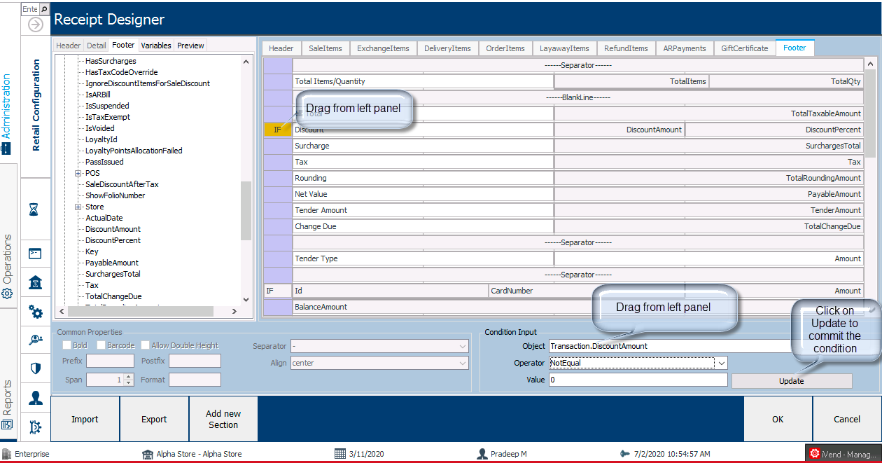

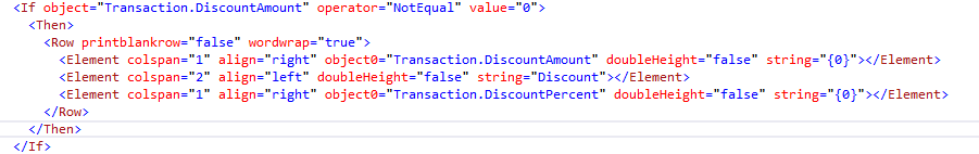

Apply conditions in the XML Receipt:
On Receipt Designer right pane select Sale Item Drag the if condition from the left pane to the blue colored middle pane. Select Formula on Right pane, the formula settings appears on the bottom pane with formula as Object. Click on Update button to commit the condition.
Figure 4 Receipt Designer- Footer

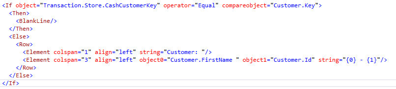

1. “If-else condition”: XML receipt has “If-else condition” to give programming condition to print the data.
 Sample Condition 1 Compare with fix value

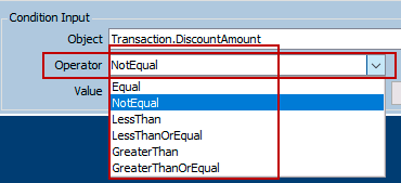

Sample Condition 2 Compare object value:
Figure 5 Condition Input- Operator option list
